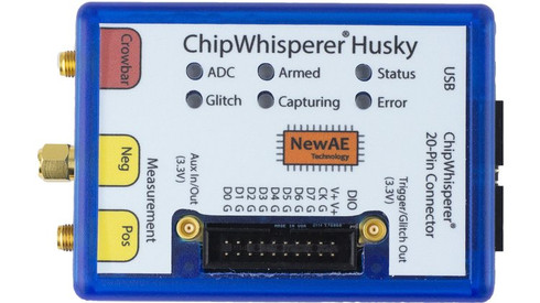

ChipWhisperer-Husky is a powerful, compact tool for working with side-channel power analysis and fault injection. Drawing on years of experience developing the ChipWhisperer-Lite and lab-grade ChipWhisperer-Pro, the ChipWhisperer-Husky adds new features like high-speed logic analyzers (to visualize glitches), real-time data streaming for attacking asymmetric algorithms, support for JTAG/SWD programming with an FTDI-compatible mode, and additional I/O expansion pins.

  • Sample Rate & ADC: 200 MS/s, 12-bit
  • Sample Buffer Size: > 80 KSample
  • Streaming Support (limited by computer buffer): >20 MS/s, 8-bit data can stream back for unlimited capture sizes.
  • Voltage Glitching: 2-size Crowbar glitch
  • Clock Glitching: High resolution glitch generation based on phase-shift architecture (sub nS resolution)
  • I/O Pins: ChipWhisperer 20-pin header, additional 8 data + 1 clock line. All I/O pins 3.3 V.
  • FPGA: Artix A35
